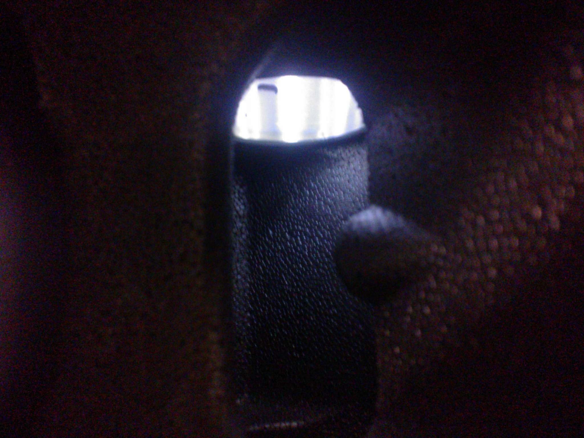

What a day!!!! Found the exhaust cam was one tooth out, so sorted that easily. Then whilst reassembling it next door popped around as he needed access to fix his fence, this meant ( it turned out ) that i forgot to re-torque the cam sprocket! Started it, sounded like a bag of spanners. Stripped it again and the exhaust cam had spun 180 degrees and the lugs on the sprocket had sheared. Yes the colour did drain although the air was blue! So, started from scratch as none of the valves were stuck down and amazingly it runs! All compressions check out too. Booked in for June 9th at Courtnays for its map and i'm gonna run it for a couple of weeks before i fit the inlet plenum.
